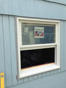

Pic 1 - old drafty window inside
Pic 2 - old drafty window outside
Pic 3 - old drafty window minus casing. See uninsulated space between window and wall studs
Pic 4 - old window shows basement paint colors over the years. 60's Aqua
Pic 5 - New Anderson 400 series in box1
Pic 6 - New Anderson400 series in box2
Pic 7 - New Anderson400 series in box3
Pic 8 - New Anderson400 series inside with valance
Pic 9 - New Anderson400 series inside with valance and blinds
Pic 10 - New Anderson400 series outside with new plastic shutters

A few more pics
Pic 11 - New Anderson400 series inside with wood sill
Pic 12 - New Anderson400 series outside with shingles and with shutters
