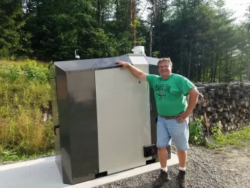

Just fired this guy up last night to test the loop. Its a Portage and Main EGR250, and I must say, I am really impressed how clean it burns. Started the initial fire with about 55 degree water, and when the coal bed established, it started to quickly puff out the chimney, went into gasser mode, and the smoke dissappeared, which I thought was cooler than hell. Heat exchanger they use is at least twice as efficient as my old Freedom Outdoor Furnace as well. Its an investment....
I swear that looks exactly like a Polar G-Class boiler and the following video confirms they're almost identical. Did P+M make the boiler or just rebrand it?
I took a look at the Polar unit at Empire Farm Days, and from what I saw compared to mine.....they looked like they put a whole lot more controls in the back to deal with. That's why I went with the PandM unit. Just enough control to make it a gasser, and a whole lot less to deal with if something goes wrong on it. I am an electrician, so it kind of mattered to me.
That's not really the point I was trying to make. The Polar G-Class design is 4 years old, I believe. The P+M EGR Optimizer is new, it kind of puts their R+D development into question if they're copying another companies products so closely.
Point taken. Let's get the legal department involved....I really don't care. Mine burns great.
