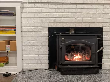

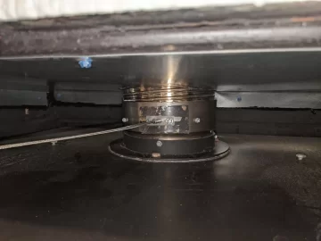

Just adding pics of my flue probe (Auber Instruments AT200 w/ 4" probe) location here in case someone ends up looking for an example. I, like others have mentioned, favored the idea of placing the probe at the appliance connector vs trying to get a couple more inches of probe height placing it in the liner only.
I must say, I really wish this flue temp probe/gauge was part of my original install plan. I am fairly certain I have under and over-fired the liner which is a terrible combination of events,,,

Yes, if we still had the fireplace and I was installing an insert, I would definitely plan on having a digital probe setup.
