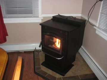

You can see by my pix that being next to windows [outside humidity?[ which are open most nice days from April thru October unless AC time,
it is prob why my DampRid box Got almost 1/2" water in it..
  • [Hearth.com] Post burn season etiquette
