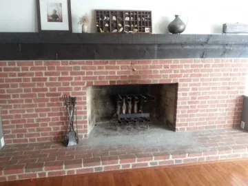

Complicating factor #1 - It's a huge fireplace, brick opening is 54" wide by 31.5" high and 22" deep at the floor, tapering in at the back and top. The hearth extends about 25" out in front of the fireplace surface.

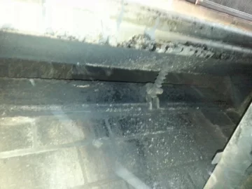

Complicating factor #2 - It has a built in shutter-opening damper (see other picture) that looks like it could limit the ability to put a traditional type of stove pipe chimney up through it. I am not aware if this is a common obstacle and if there is some technology to deal with this issue.

As far as #2 You can have the damper removed. If you were to install a Hearthstove or insert you would use a blocking plate and run the flue through that anyways. So not a huge issue and very common. With that size FP you do have options. Others will start chiming in soon with them. Best recommendation I can give is look at all your options and weigh the pros and cons, including cost and looks and narrow it down. Have you started to get the wood stacked yet?

I'd be looking for a stand alone stove that would fit the opening. That's a beautiful hearth you have there.

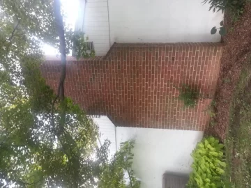

The chimney is a single story.about 15 feet tall. Here is a picture:

What is the total square foot area that you are trying to heat? That fireplace is just screaming for a big ol honking steel stove in flat black with big glass.

The damper is not a problem it can just be cut out. No smoke at all might be modern stoves are very good but there can still occasionally be a little smoke. In your case with a firebox that large i would probably do a freestander also. I see no problem with an insert but in your case the surround would be huge and i think a stove in the firebox would look better.
I agree with Holler a frestanding stove would look great. You'd have to watch clearances on the mantel but very doable. It's a matter of taste. It is a very pretty hearth and like Jags said it is in need of a nice big hunk of a stove.

How tall is your chimney? With decent chimney height and a liner, you should have good draft and no smoke should ever escape, depending on the design of the stove. As mentioned, a bypass is good insurance. A grated ash-handling system will cut the amount of ash dust escaping to almost zero.

I posted a pic above, it's only about 15' tall so a draft has occasionally been a problem with it. So a bypass and a grated ash-handling system are features I should be looking for in whatever unit I buy?

The MAJOR problem I see with an insert is the overall width of the opening you've got.
The largest Regency insert (I3100L) has an oversized surround option, but that's only 50" wide.
Not sure if Osburn even HAS that option... You may have to get creative with some brake-bent
metal to cover the remainder of the opening, or maybe you should re-face it BEFORE you decide
on which unit you're gonna go for.
