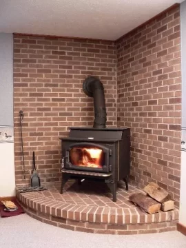

Hearth: I want it to be similar to the attached install, which would move my Englander 30 back closer to the wall a bit. (Though, not as close as the one in the picture. Yikes!) Any words of wisdom? I'm going to build the platform out of metal studs with airspace below, then 1/2" durock with brick over top. (I've never tried to lay brick before mind you....)
The Englander has nice close clearance requirements. You should be fine as long as you have at least the minimum clearances to combustibles. With all that weight on the hearth I'd put the studs on 12" centers, maybe add a center stiffner at the midpoint of the hearth and use a double layer of durock. If you want it to be extra cool add a sheet of 28 ga sheetmetal under the durock.
