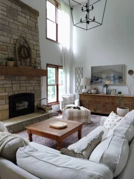

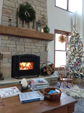

We have the fp30, maybe 4 years now. We would install it again. Our home sounds similar, 3500 sqft, geothermal, lots of windows. We have used it during a power outage for a few hours, upstairs was livable temp wise.
I am wanting to figure out a batter backup/solar recharge option for peace of mind with the wife and kids.

I missed part of your post. I can not speak to comparison with a freestanding stove but think a free standing stove would provide lots more heat.
We do have the two additional blowers installed. They go down into our basement. Original thought was if it was too warm we could dump air down below to heat the floor and turn off the primary blower. With the high ceilings we don't have the problem. Low 70s on main floor. It does keep the basement a bit warmer. I am not sure if I would put the blowers on if I had to do it again. I would for sure do the additional blowers if the unit was centrally located in the home and I could push air to say a room behind or down the hall.

Thanks Drewman. This presents the caveat. If the system is setup so that it is dependent on convection fans to deliver heat to remote locations then the performance may not be as good.
