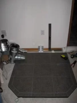

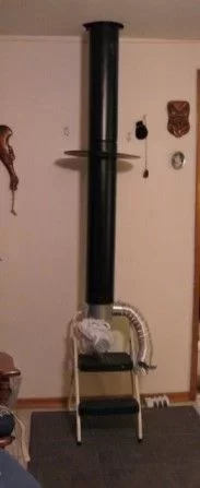

OK, work is underway. Put in the new outlet yesterday... worked on hole in ceiling and some pipe today. Here's the progress as of now. Hoping the wind won't be blowing tomorrow, like today, so I can get on the roof and finish up.
