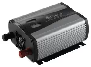

I did a random Internert search on inverters & saw this one for $29.00 plus shipping. www.donrowe.com
Lowes had the same size one with the battery clips for $39.00

If you decide to go the battery route and want significant run time, get one of the inverters suggested and hook it up to a marine deep cycle battery.
