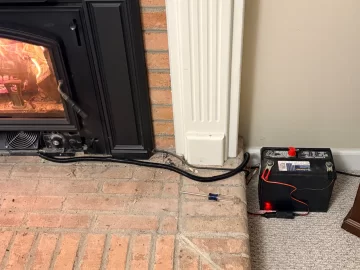

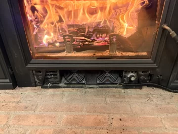

We’ve had some interesting weather lately in the Carolinas. With potential for ice and power outages, I wanted to be sure my flush mount insert would still be able pull its weight. So I got some old PC fans that run on 12V DC and rigged a setup that can be run off of a car battery. If my math is right, the current draw is low enough that it could potentially run for days
Doing the initial tests now, but so far it’s moving a decent amount of air and is very quiet compared to the factory blower.
Just wondering if anyone else has done anything similar?

Why not just use a 12v inverter on the battery, then plug in the insert to the inverter and run the regular fans. The internal fan for my BK insert pulls 30 watts. That should run for quite a while off a charged battery.

If you like the DC fans better, you could run them from a DC power supply. Or, if you had a place to hide the battery, you could add a small battery charger and run it all the time. Then when the power failure hits, it will just keep running and you are free to get more wood..
The main concern will be the heat on the fans from 24/7 burning. It might be good to add an extra shield between them and the bottom of the insert.
Yes, my approach would be to get a UPS that uses 12v internal battery and rig it up so that it can be powered by an external larger AGM battery.

After running for several hours, the fans worked fairly well. The air flow was significantly less, but still far better than running with no fan at all. The house warmed up and is holding as expected. The fans themselves are running cool because I have them angled lower and away from the hot spots on the stove.
I considered the inverter approach initially but was told the run time would be limited with a 180W fan. The 12V fans are drawing roughly 6W so I should theoretically be able to run for a few days.
Overall, it looks like it'll work in a pinch and for around $25 it was a fun little experiment.
