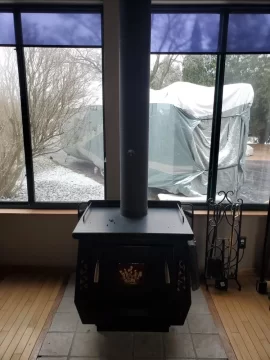

I recently bought a very nice blaze king ktj-302. I have some questions about it. Im unsure of how to correctly use the thermostat. There are times where i have a great bed of red hot coals and reload the stove, wait for a active fire before sealing the door and it may be a great burn (600 to 700 degrees via pipe probe). Other times i can have a great bed of red hot coals, wait for an active fire and seal the door. My probe quickly tells me im burning way too hot (1100+ degrees) and other times i may burn to cold (less than 300 degrees). So how can i have a great burn for a load of wood with the thermostat set directly between low and high, reload, wait for active fire and not get back into the same temp range? Sometimes i get lucky but most times i have to fidget with the thermostat to tune it in. And im talking a few degrees one way or another could be the differences between burning to cold or burning the house down. Thoughts?

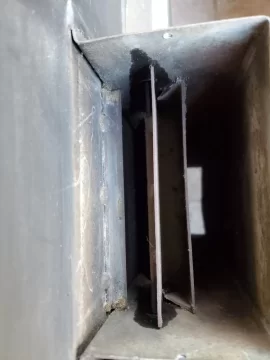

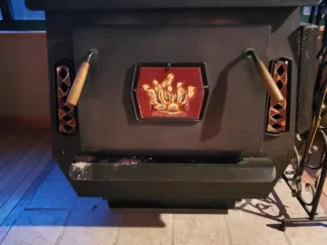

The door gasket is 1.25". When you close both handles, does door pull into gasket? Post picture of the thermostat assembly. There were two types, bimetallic spring with a loop or the other with a rod.
I assume this is the original gasket bcuz it was used very little. There is not much resistance when i seal the door with the handles.
[Hearth.com] (pre epa reg) blaze king ktj-302. [Hearth.com] (pre epa reg) blaze king ktj-302.
Replace with new 1.25" diameter please. If it's still loose, CAREFULLY bend paddles on inside of door handle to increase tension.
Ok. I will do that this weekend! Is that the first step BEFORE you'd like to say anything about the thermostat? I understand who you are and appreciate your help sir.

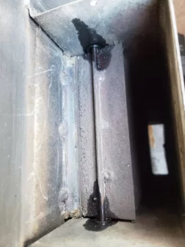

There are no parts available for the thermostat. I can see a fair amount of debris and corrosion. I would try to clean (WITH ABSOLUTELY NO FIRE BURNING) with some brake clean.
Then clean and lubricate the thermostat blade under the lid.

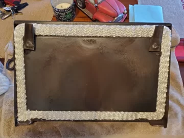

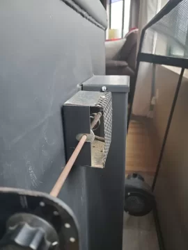

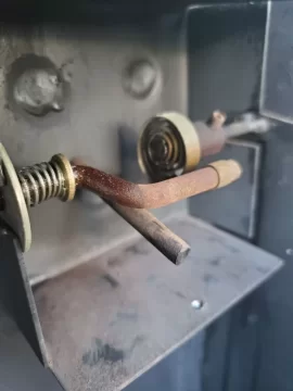

Ok, i have relined the door with a new gasket, sprayed thermostat coil with brake clean, thoroughly vacuumed the airflow channel and butterfly choke as well as lubed all the moving parts.
[Hearth.com] (pre epa reg) blaze king ktj-302.[Hearth.com] (pre epa reg) blaze king ktj-302.[Hearth.com] (pre epa reg) blaze king ktj-302.[Hearth.com] (pre epa reg) blaze king ktj-302.
Does the door now pull in tight?

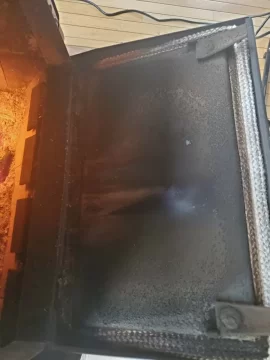

Well, i actually had to bend the inside tabs of the handles inward very slightly because it now needs to be forced closed. Im sure that it is sealed tightly but the handles will not go down all the way unless i bend the tabs more which i don't want to do. The handles should be vertical but this is as tight as i can get them. Prior to bending them, they would no engage. I used 1.25 inch rope as you said. Perhaps i should of used 1 inch....?

Keep 1.25". It's supposed to be tight.
Thermostat regulates air into firebox....but the external spring designs were not as engineered as today's.

So you said the thermostat regulates the air going into the firebox.... i get that. So is the coil designed to add or subtract air as the fuel heats or cools in the firebox? Therefore regulating the heat temp coming out?
