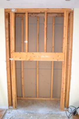

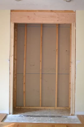

I managed to get the old framing out and put in a new header this weekend. Before and after photos below. Now, I need to work on insulating the chase and determine whether it should be faced or not, and what to put over the insulation; Durock, type x, ?
  • [Hearth.com] Pre-Fab to High Efficiency ZC Wood Burning Fireplace project.

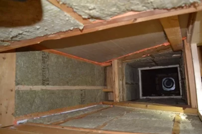

I managed to get all the Roxul insulation into the chase, up to the attic firestop. That's as far as I am going. My chase is very unusual in that it starts 53" wide on the first floor level, but is very irregular-shaped for the next 5 feet. Then, it finally turns into a 24"x 30" chase after that. It would be nearly impossible to cover all of that with sheet rock or anything else, so I've tried to frame as much as possible to allow for insulation, and block off where I could. I decided put the most emphasis on the common wall so that fire would have a harder time breaching our master bedroom above, and would more easily go into the garage, allowing us time to get out if a fire ever did occur.
Next, I need to put type x up on the common wall to cover the Roxul. For the other 3 sides I am just going to secure the insulation in place.

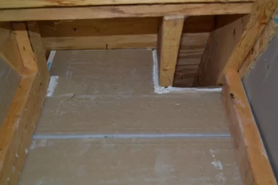

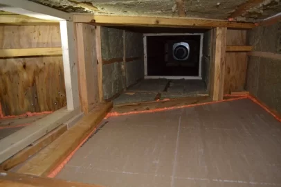

Now, a few pictures after partially framing the attic floor firestop, adding some blocking for insulation and sheetrock to attach to, and adding Roxul.

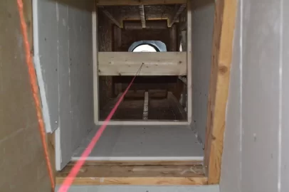

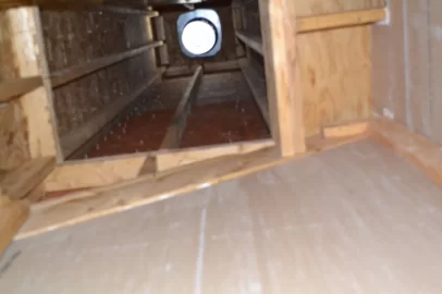

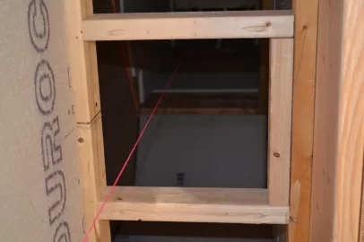

Busy week around here. I put up type x sheetrock over the Roxul in the area between the 1st and 2nd floor, then put a 2x6 up at the 2nd fire stop to drop a plumb line down.

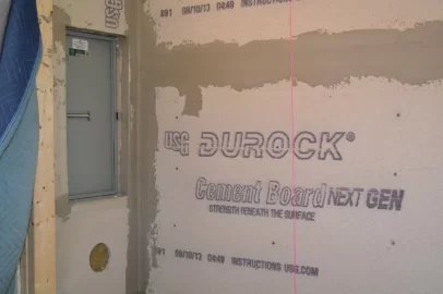

A couple days later I put Durock up over the insulation in the 1st floor chase area, installed the fire-rated access door, and cut the holes for the outside air kit. The night before the chimney install I finally put Durock on the floor too. I finally decided that the floor would be two layers of Durock with stainless steel on top. One reason for the stainless steel was to make the install easy, assuming we could just slide it off the dolly and into position.
Then, I called the electrician to confirm Friday's blower install, and called my father in-law and other helper to make sure we were all on track for Saturday's chimney install.

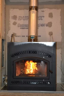

The 16th is here and we are on schedule for the chimney install. I managed to get the first floor firestop framing in and finished the Durock on the first floor chase area. When the guys got here we installed the 1st floor metal firestop from below and then the roof support from above, through the hole I cut in the chase wall from the garage attic. (I used roof supports at the 1st fire stop, 2nd fire stop, and top of the chase). The guys put the chimney together and pushed it up through the hole with a little help from me above. Then they sat the pipe on the floor while we went to work on the other fire stops.
From the workshop we framed the 2nd floor fire stop, attached the metal Security Chimney fire stop piece to the bottom and a roof support to the top of it and drilled Kreg jig holes to the top so that it would be easy to install from the attic hole that I cut. We did the same for the top of the chase frame, and added some plywood to raise it up enough to be flush with the siding and give a good surface for the stainless steel chase top that my father-in-law built to rest on.
I climbed into the attic and got that into place, while the guys pushed the pipe up through the 2nd firestop.
Then, we switched places, with my father-in-law going up to the top of the chase and me going to the bottom. We fed the pipe up through the top of the chaseand he tightened the roof support to hold it...but, it slipped. So, I went up to the 1st floor roof support and tightened that one, which held it in place.
We moved the stove into place, using the 36x24 dolly I had made to allow me to move the stop around the past couple of weeks. Two of us tilted it on to the stainless steel floor and the other pulled the dolly out. It easily slid into position.
We put the offset (15 degree, 2 foot piece, 15 degree) into place and screwed it all up.
After attaching the outside air kit and tightening the middle roof support we were ready for the big test burn...
and there it is...
The two keys to the chimney install were the best father-in-law a guy could ask for, and a best friend who's smart and loves to do good work. They were both great at coming up with the way to make this happen, because until today I wasn't really sure how we were going to get the chimney into place. My best friend said we should go from below and we just went with it. It was actually pretty easy thanks to them.
A couple of observations so far.
- The pipe is much hotter than I expected it to be. It's too hot to touch for more than a few seconds.
- The back and sides of the fireplace don't get hot at all. All parts of the face get very hot, very quickly.
- This fireplace is very efficient. The fire above was just sticks and it burned for a long time.
- The blower isn't noticeable when the fire is going, and it definitely heated up my face from the couch about 12 feet away.
- The first two burns are just like everyone said; stinky. I've followed the instructions and kept them hot and short, hoping to cure everything and burn off that smell.

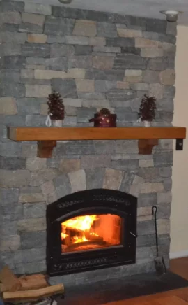

Ok, so I put the stove in last Thanksgiving and burned all year with it open, because I didn't finish the stone yet. Now, the stone is finally done. It was a lot of work, but a lot of fun too.
After a year I can say it is a great stove. It heats my 1850 sq. ft. colonial with the blower on. Things went according to the plan I shared earlier except for the 11 month gap to work on the stones :). If anyone wants the project plan please let me know and I can email it to you.
