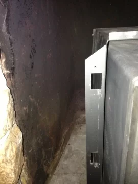

So my osburn 2400 arrived Wed. While I had measured countless times before I pulled the trigger I was quite surprised with the overall size of it!! I bought a bag of roxul today, to fill in around the sides/back but not sure there will be enough empty space to bother with it as it currently sits.
When my Jotul was installed they only took out the door and bottom flooring so the steel backing and sides of the old school fireplace is still in there. Is there any reason to ripping the rest of this out if i dont need to? See last pic.

If you have the hearth room use the maximum extension out of the fire box. That extra 3.5" of stove sticking out does make a big difference.

I thought that blanket was going to burn too but it does not. We just installed this same unit last week. It's awesome you are going to love it. It heats up quick and gives off a ton of heat. I was surprised how big it was. We had to modify fire place a tad get back corners all the way in. After it was in I put roxul where I could, not much room in either side of it. Awesome stove though. You will def enjoy it.

I bought a bag of roxul at HD over the weekend, with the idea that i was going to insulate what open area was left around the insert and then the above my block off plate.. Well after getting the surround off my Jotul and remembering my firebox cavity is slightly angled in front to back I dont think I'm going to be insulating around the insert (due to less open room than previously thought)
I still want to insulate the plate, but at $50 for the bag of Roxul that I will only use a 2'x1' piece, that's alot of insulation to not use or having any future use for. Are there any other insulation options that woudlnt come in such large quantities??
Use the Roxul to pack the top portion of the chimney and above the damper for as far as you can. Then put in the blockoff plate.
I'm tempted to try and push it up in there but i'm afraid i wouldnt even get 1 batt in the bottom and the top is already sealed off.... Arrgg and I know once I open it, its mine and im not really interested in having another roll of insulation collecting dust in my garage next to my r-13...
