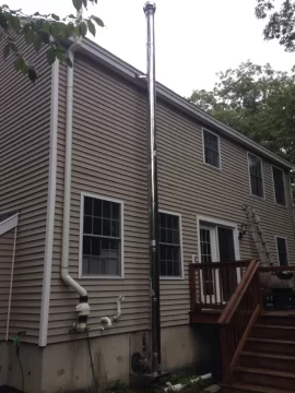

[Hearth.com] Pre-making the fire [Hearth.com] Pre-making the fire What reverses the draft back to normal on a cold start is opening the door to the garage and usually opening a bay door if needed. I can feel with my hand when the draft is going up the chimney and I can light it with no smoke spillage. Once the fire is started I can close the garage doors almost immediately and it won't backdraft until it cools way down. I have a small window in the basement but it'll still backdraft even with it open, I don't understand why but the garage doors work 99% of the time. The co alarm hasn't gone off in over a year so I'm gonna just keep doing what I'm doing. One of these years I want to move it up to my main floor. Pics attached of the chimney setup. I know it's not quite code but I'm working on it. It's solid

Why isnt it to code besides the missing lateral support bands? It it not high enough?
How is any real heat making it upstairs with all that concrete sucking up your heat?
It looks funny going through the wall

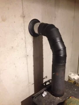

Ho...wait! Looks like 8" stovepipe stuck onto a 6" class A? Weird!
Just a length of class A through the solid masonry. Is that contrary to code?
No but the stainless inside is not class a pipe and if you zoom in outside the price connecting to the tee looks odd. It may be fine but I can't see it very well and something looks off.
That radon mitigation system may be part of your CO problem.

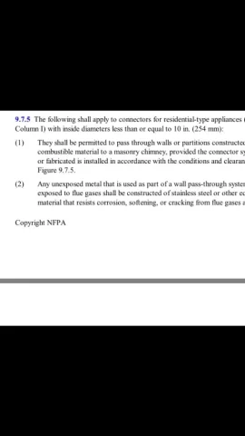

[Hearth.com] Pre-making the fire It's 6" stainlessingle wall going through the foundation, if I were to do it again I would drill the hole bigger for chimney pipe instead of single wall. But I can get some upward angle with the single wall. Anyways I was under the impression that single wall stove pipe through any house wall is not to code and needs to be chimney pipe extending 3 inches into the home. I also was reading the code where it says that it only needs to be stainless connector pipe if it goes through a wall. I'll put up a picture of what I am talking about.
As for the wall bands I have them but I have to make the brackets that mount it to the wall.
I believe the height above the roof is good but I haven't measured it, i've been up on the roof once and it is pretty scary.

I had also thought about the radon system, next time I start a fire I'll unplug it and see if it changes anything
View attachment 235619 It's 6" stainlessingle wall going through the foundation, if I were to do it again I would drill the hole bigger for chimney pipe instead of single wall. But I can get some upward angle with the single wall. Anyways I was under the impression that single wall stove pipe through any house wall is not to code and needs to be chimney pipe extending 3 inches into the home. I also was reading the code where it says that it only needs to be stainless connector pipe if it goes through a wall. I'll put up a picture of what I am talking about.
You need to follow the instructions for the chimney system to be to code. I am pretty sure they don't allow you to run single wall through the wall.
What are the other pipes with the elbows? Are they make up air piping?
