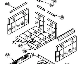

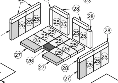

The Escape 2100 is poorly named, should be an escape 2900. Drolet marketing has been playing loose with the firebox size. This model looks closer to a 2.75 usable firebox size. Compare the firebrick pattern to the larger Baltic II. Both are supposed to have 3.5 cu ft fireboxes. The lab test for this series found the firebox size to be 2.88 cu ft. The HT3000 appears to have a better convective deck vs the simpler one on the Escape.
[Hearth.com] Preemptive Stove Purchase?Escape 2100 [Hearth.com] Preemptive Stove Purchase? Baltic II [Hearth.com] Preemptive Stove Purchase?HT 2000
Reactions: WinterinWI
Interesting. Do you know how the lab determines firebox size? Do they just take a few inches off for clearance to the sec tubes, and some room by the door?
I think the Baltic is smaller though. Based on the drawings, I'm coming up with 3.43 for the escape 2100, and 3.36 for the Baltic. Obviously not all usable as the secondary burners are in that area. But I still think the Baltic would be smaller.

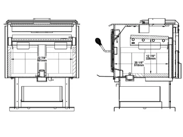

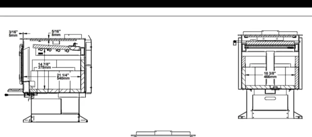

The lab report lists the precise firebox dimensions that they tested with. The Baltic II has a slightly deeper firebox. Note the extra front firebrick.
Yes the baltic firebox is 1.125" deeper, but the escape 2100 is 4.5" wider, and roughly the same height. That's what the dimensions in the manuals show anyway (shown dimensioned to inside of firebrick). Its in the pictures I attached a couple posts up. Doing the math, the cf comes out slightly higher on the escape than the baltic.
Anyway, didn't mean to hijack the thread. Good luck finding a new stove longknife.
You could very well be right. The Baltic has an extra row of full-sized bricks laid sideways on top. Not sure if this makes a difference. We need a measurement from firebox floor to the tubes. I could only get the actual lab measured firebox dimensions from the Solution 3.5 test docs. Couldn't find them in the older Baltic II test docs.
Going off of the dimensions in the manuals, the firebox cf of the escape 2100 looks slightly bigger than the baltic II. Not enough to make much of a difference, but if the escape is truly 2.88cf like you say, that's a much bigger difference. Shouldn't have to go down to a stove shop with a tape measure this day and age. Maybe I'll hold off on the purchase for a little bit. Thanks for the info.
