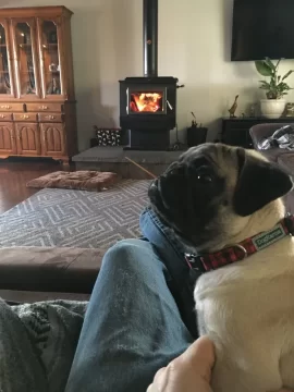

My dog smokes but my cat doesn’t. This pup is almost 5 months and loves those fir twigs.
