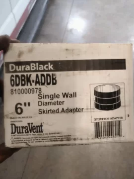

Lindeman carries a skirted adapter that works well I will go down a take a picture of one in a little bit
Reactions: kennyp2339
Here it is
  • [Hearth.com] Problem fitting 6” stove pipe in Timberline woodstove
Thank you so much for all your help. I will definitely look for this adaptor as my effort to crimp has been unsuccessful. Very much appreciate your time, energy and expertise.
