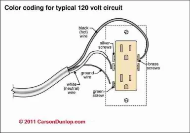

Check both the motor for sure but for safety sake also check the receptacle wiring to make sure it is correct. In a 3 wire receptacle with the round ground lug at the bottom, the wider left prong should be the neutral and the shorter right prong should be the hot.
