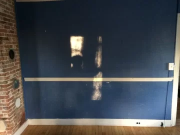

I started with this:

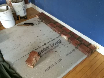

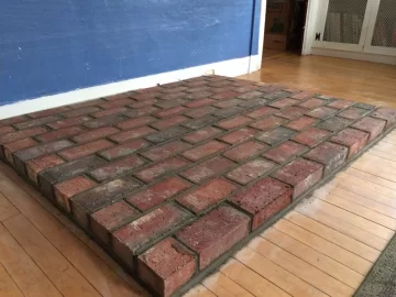

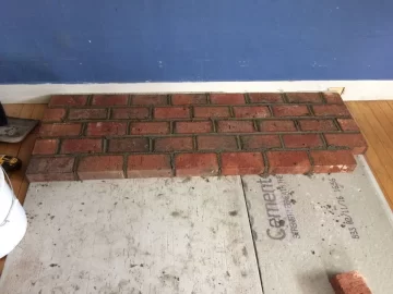

I wanted the hearth centered between the chimney and the doorway. Yesterday, the sweep made a hearth for us:

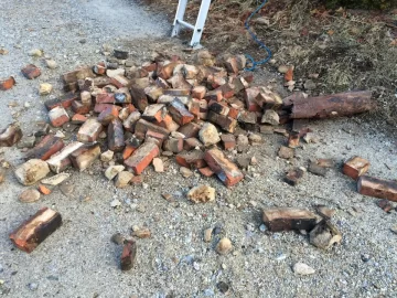

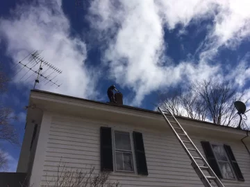

Next, it was time to demolish the old chimney above the roof line. It was beyond any sane attempt at repair.
In the space of about half an hour, this...
Became this...

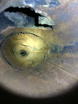

Next, it was time to see about dropping a liner in. Heavy duty, smooth-wall liner that will have insulation poured in around it due to the irregular nature of the inside of the existing chimney.
After testing the way down and finding some pinch points, the sweep came up with a few creative ways to smooth them out. They were places where they'd put screws through that didn't catch on the inside liner and just dented it in. After much thought and not a small degree of effort, he was able to successfully drop the 6" liner down inside the chimney.

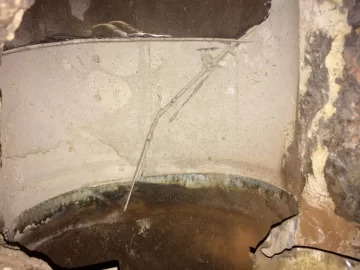

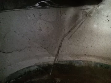

If you're curious, the mortar surrounding the existing 8" liner looks like this (you can see it where they ripped out some of the liner):
With Flash
Without Flash

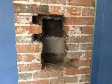

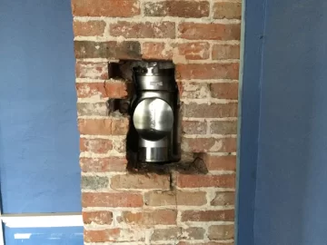

Before the liner dropped, here's what the opening looked like:
And after:
I have a supply of the antique brick here, and they used that to fill the gaps back in. The mortar is setting now, and I should be taking delivery of the Progress Hybrid tomorrow. I opted for a bluestone chimney cap, so I'll try to get some shots of that, too, when it's ready. They will start rebuilding the chimney above the roofline tomorrow.
Became this...
With Flash
Without Flash
And after:
