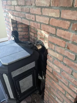

I had installers put in a new PH last March and am just now getting to use it frequently to heat our home with the cooler weather. I'm getting decent draft and the stove functions well overall. However, I'm finding that if I have the door open more than a few inches when reloading I get smoke spilling out of the top of the loading door.
I've tried to vary my loading technique (e.g., load at 200-300 when coals are very low, heat up flu w/ kindling before reload, open window facing wind, etc.) and nothing seems to help. Top-down technique and waiting until stove is cold (100 deg) for reload seems to be the only way that works for me. I always open bypass and air all the way up when reloading and use <20% MC wood.
Here are some details on the set up:
  • PH is rear-vented directly into liner at a slightly upward angle
  • House is 1984 construction, new windows, but not air-tight
  • Internal 25+ ft multi-flue masonry chimney
  • One large screened cap on top
  • New 6" SS liner (uninsulated) inside clay flu tiles.
  • Installers told me there is a bend in the flue inside the masonry (it's <90 degree). They also said they are certain they left the clean-out cap on the liner when installing.
Any thoughts on how I can improve the draft to avoid smoke spillage?

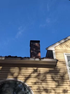

does the chimney adhere to the 10-2-3 rule? is it at least 2 ft higher than any part of the structure within 10 ft measured horizontally? it looks like the roof to the right in the image you provided might be within 10 ft and it doesn't look from this angle that the chimney is 2ft+ higher than that. so the top of the chimney might be sitting in a positive pressure zone.

It is hard to see based on the angle the picture was taken, but the chimney is the higher than the tallest portion of the roof. Not sure if it's 2 feet, I've never been up there to measure it. Good thought though..

The picture posted earlier makes it look like the chimney is lower than the roofline to the right. Does it comply with the 10-3-2 rule? Is this in a 1 story part of the house next to a 2 story part?

The picture is a bit misleading. I believe the chimney does comply. It's at least a few feet above the highest point on my rooftop.
