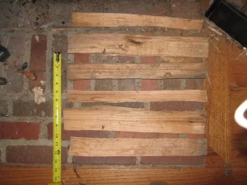

I always thought smaller splits burned quicker. This morning I loaded my Progress with "splinters" of oak. They were 3 year seasoned oak 16" long split mostly to 1"-2". Most would say this was kindling wood. I packed it tight and let her rip - leaving the draft open much more than usual since it's so cold. I figured I'd be reloading again pretty quickly. Keep in mind the draft was open for good heat, so I was not expecting a 12 hour burn.
Exactly 5 hours later there were still tons of flames, the firebox was 1/3 full of wood and coals, and the stovetop temp was 450F and throwing tons of heat. I was not in "cat" mode for any of the burn, there were lots of secondary flames the whole time.This was just as good if not better than if I loaded with my "normal" size splits that are 3-4" on end. I'm starting to think smaller splits pack tighter and burn longer.
I am getting about the same total burn time as with normal split size, but I am getting higher temperatures for a longer period of time. My guess is that not too many folks have tried running this stove with wood split so thin.

Well... could those smaller pieces be significantly dryer than your larger ones perhaps? I can't explain it one way or another... maybe you got more wood (in terms of mass/weight) in the stove using those smaller splits as well.
I guess it's possible they are drier, but I would think after 3+ years all my wood is pretty dry.I think I fit more mass in the stove since it was packed so tightly. The stove room is 70F 8 hrs after loading and it never got over 17 degrees today.
This is way better than any load I have ever burned, keeping the house warmer in such cold for so long. Funny thing is that my cat has not been lighting off well lately, and this burn was all secondaries.

Wow, that's nearly kindling sized splits for me.
Wow! Those are tiny. I think you probably got more in there all packed tight than usual. I bet if you were trying for a long, low burn you'd still do better with big splits. Maybe it doesn't matter as much with a higher rate burn. Then again, if you've got super dry oak all packed in there tight with minimal air gaps, it's probably not much different than having big splits anyway.

I'm sure it's just the mass you get in there. Usually, you'll get more mass by using large splits, especially if they're square-ish. But, if you have a bunch of small splits that are square-ish you can get a ton in that way as well.

I think you guys are sending me into a rat hole with this weighing splits thing! Unless I get a really accurate scale, repeatable split densities, and tons of time, I think I'd go nutso. All I can say is when I filled up my firebox with nearly perfectly packed tiny splits of oak, I got tremendous heat and did not see a difference in burn time. It's probably important not to loosely fill the load, or it would burn faster.
Tightly packed was the key, which was easy with my nice and square oak "SPLITNERS". Hey I just made a new word!
