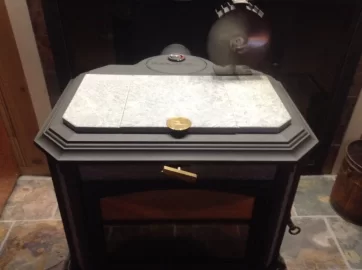

I think if the cat failed I would still use the stove, but with the cat engaged and a black box you are definitely saving wood. My ideal steel seems to burn lower then the Progress though. I can go an entire burn without seeing a flame with the control closed. Cat temp stays up around 1400 degrees and slowly comes down.
Humming right along...
  • [Hearth.com] Progress operation??????
Reactions: Huntindog1
Low and slow [Hearth.com] Progress operation??????

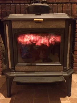

I was sitting by the stove and it made a load noise thought a log had settled down, then it did it again I guess it was back puffing it is only 50 degrees out so I opened the air and got it going nice.
