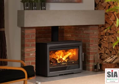

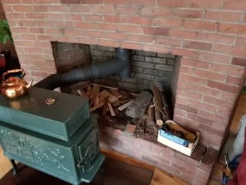

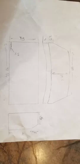

Given our firebox is ~48 Wide x 30 High we are very interested in a unit with a similar aspect ratio. Something like the image below would be ideal but all the options I'm seeing online that have that ratio seem to be UK or European based companies, which is fine, but I'm not seeing availability in the US. I've included the dimensions (clearly not to scale) of the firebox and a pic of my space as well.
