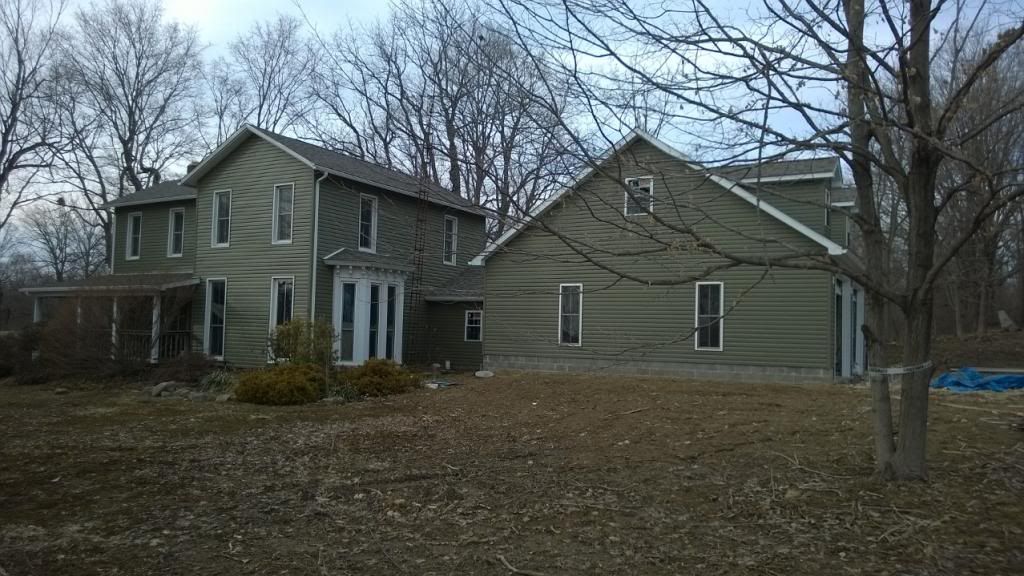

Blah.... Maybe it's my boiler? I always thought the Tarm HS systems were top notch..... This house is old, but was completely remodeled 20 years ago. gutted. Its insulated, not drafty. The whole place is now properly zoned - 5 to be exact. probably heating 3k square feet... I have a Harman Accentra insert that I haven't installed yet in my addition - not sure that'll help or just make it all seem more expensive lol....

Roughly 3k square feet. It was remodeled 20 years ago...completely gutted...insulated, new windows. The original house is wrapped in wormy chestnut, then wood siding, then insulbrick, then tyvek, then vinyl siding... I suppose the original insulation could have sagged by now? But how do you tell? The windows are Certainteed replacements - floor-to-ceiling models. It would be cheaper to buy a new house than to replace them again lol.
