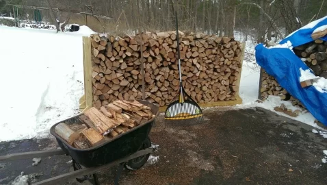

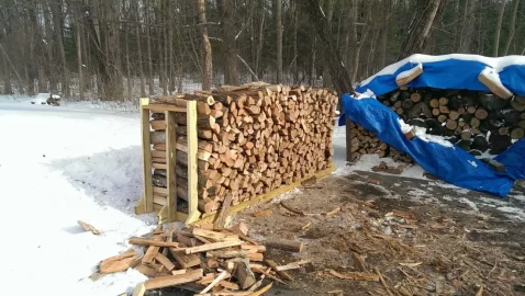

After the delivery I built myself a rack and stacked it up. My rack measures 9.5'X4'X32", which, Ill save you the math, comes out to 101cuft. I built it expecting to stack an extra foot above the side rails to make a full cord.
When all is said and done it fills the rack exactly with a small wheelbarrow of basically kindling left over.
I called the seller and told him what I have and he said that the state allows them to measure a cord as low as 100 cu ft at the customer sight due to differences in stacking technique. He says that due to the way I stacked it (two rows as opposed to one row) I am removing ALL air space and that I do in fact have a legal cord. said OK and hung up. I then looked up my weights and measures departments sight and they all tell me that I should have 128 cu ft with a TIGHTLY stacked rack. I called him back, said I was still sore and he told me he would deliver more and to next time buy from someone else, not in an angry way but to use as a comparison.
What do you guys think? Is he trying to pull one over on me? Over 20+% less wood than expected seems a little low to me. If it had been 115ish cu ft I dont think I would have called him back. Ill upload a pic for you to see. I want to make sure I am not being a jerk here. I feel that I paid good money and didnt receive what I paid for.

Im a dope. I didnt take into consideration that the wood hangs over the rack.....so, it you over estimate a bit and call each peice 18" you'll have 9.5*3*4=114+a little wheelbarrow call it +3. Gives me 117. Again this is an overestimation in his favor. Would you guys consider this close enough? He is still offering to deliver a little more but if this seems right Ill tell him not to come. Should I be expecting to measure 128 or am I stacking too tight and expecting too much? does anyone ever come out with 1 cu ft extra with these guys?
At 117 cuft, I personally would call it good enough. That can easily be attributed to a little "honest" mistake.
yup, let it go....however, i'd admit my measure wrong and work on that relationship, especially if its good wood. i'd also point out that you were curious and found on firewood sales standards that sellers are bound to sell a cord of 128 cu ft, not close at 100 as he suggested.
I would be okay with 117. But you gotta wonder where he came up with the 100 cu ft excuse
