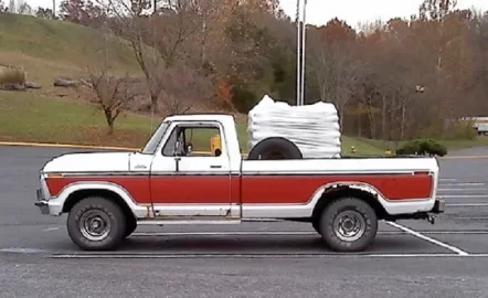

It is roughly 15 miles one way to the local Co-op where I get my pellets. They will bring them to the house and unload for$10 a ton, but might go up like everything. Usually I get them to haul if getting 2 tons.
Often in the past, I drove my '77 F-150 and let the man load a ton pallet onto my bed liner, then he pushes in a ways, then lay a secound empty pallet behind the loaded one, and pushes the loaded ton pallet to the front of the bed. Then after he backs away with the empty pallet, I shut the tailgate.
I have let them just hand load a ton from the loading dock in the bed, placed around and as close to the front as we can do. Co-op has a bunch of great guys, I've watched a few grow up. Usually I only load a ton / 50 bags on my truck, but in the early years
I have hauled as much as 75 bags a time or two when was going to a place 25 miles north and they had a sale going. Hand loaded, I had a shell on it and a buddy helping me. That is 3,000 pounds, and after a time or two, I cut back. If I did it now, likely I would use my trailer.
In the early years I was unloading at the basement, stacking my pellets in the basement. I was always hauling then. Last 15 or so years, I store them on the carport so they can back the flat bed in and set them off and I'm not climbing stairs with pellets no more. After unloading my pellets, and they are stacked on my old pallets, they put the now empty pallets on the flat bed and they strap them and the wrapping down with the straps they carry. They do use straps hauling on the flatbed because that bed is slick enough they'll slide.
Below is a ton on it, I never tied a load on my pickup, never had as much as a bag move either, nor did I roll it. I always treat my truck well too, That truck is all white now, new everything except cab and hood, new bed liner too. I have a '07 but it has a bed cover on it.

Now days my pellets are delivered because I don't like handling them when I get home, no forklift or big enough tractor. When I use to pick them up I had the guy at the co-op set them in the truck back up about 2 feet lift and push. Close enough to the center of the axle for me. Next step slam the tailgate and drive 5 miles home, watching out for the other guy to do something stupid. Putting a strap on them never occurred to me.
With a full "ton +" on my F-150, I think it is better to shift some of that weight to the front axle.
