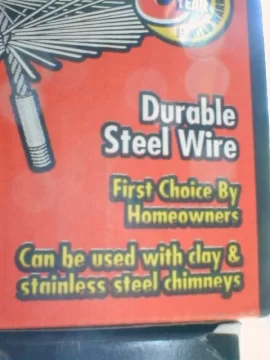

I have no clue why misinformed folks say no metal.
I use a metal brush and have no problems. Cleans better than a poly, and says RIGHT ON THE BOX, 'FOR USE ON S.S. OR CLAY LINERS.
Use which ever is your fancy, but there is nothing wrong with using a metal brush, especially when it says ok for s.s. liner right on the box.
Nuff Said.
Edit:
If you can remove the baffle, you don't need a bag, you merely remove baffle, close door & air intake, brush down the mess, and scoop or shop vac it out, done.
Everyone has their way of doing things. Research what will work best for you. But IMO, some folks get a tad zealous pushing something based on information that is hearsay, or just opinion.
The photo says it all. Next cleaning, I'll take an interior pipe photo, so you nay sayers can be better informed ;)
Another plus of metal brush: mid winter, top end may have some build up (after you learn your stove & burn dry wood, this should not be a problem), you have to shut down & let go cold for poly brush, not metal ;)
My first year, I had wet wood & good amount of build up on top foot or so, brushed with steel brush, what fell down burned, and the pipe was cleaned & no melted poly to boot. ;)

Yo, Hog...
I got it straight from the horse's mouth. SELKIRK DOES NOT RECOMMEND USING METAL BRUSHES. I wonder if you dump "engine cleaner" (diesel fuel) into your crankcase between oil changes? The package says it's safe for all engines!
Edit: I use poly brush, so that's TWO false claims on that package!

No problemo, I have a call into Duravant (Simpson) regarding the brushes. Happens to be the liner of my choice & install.
I'll keep yall posted on their input for their particular system. I'll still take a pic when I get the sucker cleaned this year.
As far as engines, I do regular oil changes on mine, no need to dump cleaner in ;)
If regular oil changes don't work, the shop can flush the engine out, and if any problems ensue due to that, they eat it with their liability insurance.
I have no doubt that the metal brush works, and probably better than poly. In fact, you might never see any ill effects. But this is just one case where I'll stick to "manufacturer recommendations".
If the stainless flue is rigid, heavy gauge, then a metal brush is likely ok. But if it's a thin stainless flex liner, I would use a poly brush.
Just got off the phone with Dale at Simpson Duravent. Excellent guy, very nice & helpful.
He advised for Duravent system, either poly or steel brush is ok. Didn't push one over the other.
He said they must test to UL1777 test, and must take brush up & down liner 100x. I did not get deep into it and ask further.
This is the same guy that helped me plan the liner parts I was to use. Very awesome and helpful.
So , it depends on the sweeper/homeowner preference, and also the liner manufacturer.
I will say I only have 5' of flex at the bottom, with double wall insulated rigid from first flue tile up to top.
Although I don't have much problem when I get to the flex, I could see the poly making for an easier cleaning process for some with full flex liners.
For me personally, I want to clean as much with as little effort as possible. The steel brush does this for me.
Everyone has to figure whats best for the system they have and their cleaning technique.
