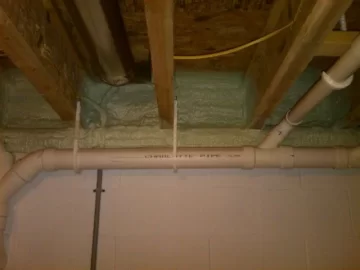

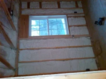

We used closed cell foam to seal up between the block and the band board / joists. We used open cell foam ( cheaper ) in between the stud cavities in the wall and underneath the soffit vents. I paid someone to spray it. The foam comes in drums as a liquid and they have machine that heats it and pressurizes it. More info: http://www.icynene.com/residential. It is about double the cost of batt insulation but it actually seals and insulates where batts just insulate.
Closed Cell

Open Cell ( sideways for some reason and I cannot fix it )
