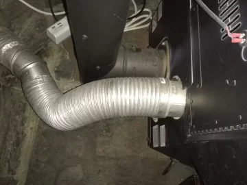

I thought it was great deal too. Will set it up and run it for test and drain and put away hopefully never to get used. I need way to run power cord thru OAK (Outside Air Kit) Pipe and leave extension cord hanging. Or just stuff towels in sliding door? What does everyone do when you need to use Generator to power Pellet Stove? I have 12 hours of Battery Power. Generator is for longer time and it will charge the Inverter/Charger/Batteries I hope and run the Pellet Stove.

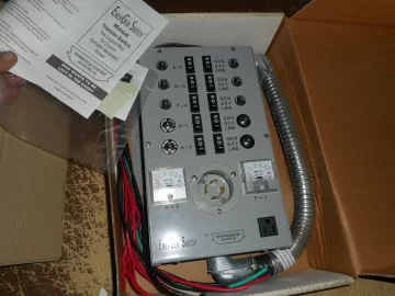

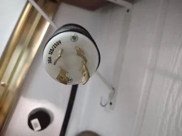

This is what is in the Closet from Transfer Panel. We have Extension that we run when needed thru wall (POC Pipe with Caps on Ends). Is there adapter for 110v Cord for this?

So no such thing as
NEMA L14-30P to ELECTRIC PLUG, 110-V, to 3-PRONG cable?​
No biggie if no such thing. Hate to lose 7k Generator by using Transfer Panel for little 1k Generator. Can always run 1k PSW Generator on back porch and run extension cord to pellet stove Inverter/Charger. Stuff some towels in the slider opening we create and Win/Win.
Transfer Panel does have 110v 3 Prong Outlet on front of it. I assume it's not for Input. Manual Says Nothing about it. Transfer Panel Instructions are few messages back. This is the same model. (broken link removed to https://www.ebay.com/itm/403407042295?ff3=2&toolid=10044&campid=5337240130&customid=1234&lgeo=1&vectorid=229466&item=403407042295&mkevt=1&mkcid=1&mkrid=711-53200-19255-0&ufes_redirect=true)
That 110 outlet is for powering lights and small stuff. Not Input. Back to Towels and Extension Cord. hey it's not going to be used. Any other suggestions?
Emer Gen Switch Transfer Switch Model 10-7500 7500 Watt Max​
They do make an adapter but you get the same phase down each leg of the panel meaning only 120v circuits will function or be useable and on a small generator just lights and such realistically.
15amp to l14-30p -Home Depot
