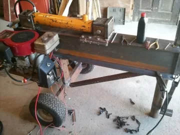

Did I hear "overkill"?
Now THAT I beam is overkill. (I stole it from a bridge).

Wish I had some pics of the splitter dad and his friends built and shared when I was growing up. Massive. They salvaged all sorts of parts, I think the axles was off a hay wagon or similar, with the corresponding wheels. Had an old wisconsin spin start engine out of some piece of farm equipment (a bailer maybe?) a ram off some big old loader for the town (one of the guys worked for the town). The I beam may have come from a bridge for all I know. They made big plates that slid into a channel on each side of the ram, I remember I couldn't even lift em. Made a nice working area the size of a card table to split on. You couldn't move this one around by hand (compact truck was a little sketchy too lol). Would split about anything but of course no vertical splitting capability. So you were limited by what could be lifted onto the splitter. I recall a few big rounds we had from the town when they widened the road a dropped all the logs in our yard... there was one when I was in 7th grade that dad couldn't even get on there and we both tried to lift it together. Maybe about 4 foot across? Of course the first time I tried I wasn't prepared and after we got it about a foot high I dropped it. Took off half the skin on my forearms. Went to school for a week or so with purple, black& blue forearms. The second attempt we got it on the splitter. Personally I'll take overbuilt any day. In case I happen to back into it with the tractor or by barn falls in. Splitter will still be good! ;) But I'd devise a better way to get the big rounds on deck <> But these new little splitters are pretty convenient and still split pretty much anything. I'm still shocked when I walk by them how tiny they are all, but hey, they work great! Good luck with your new splitter sorry for my tangent back on memory lane. I got to go out and use the axe now... :(
Looks like it is "just right" to me!
