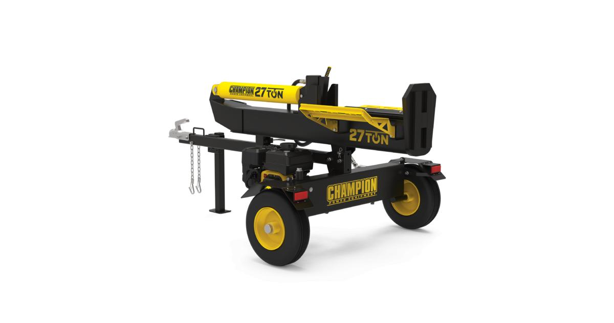

I have a low hour champion 27 ton splitter, I’m the original owner and have split around 2 or 3 cords with it.
I did a routine oil change the other day and noticed the bronze colored glitter in the oil that was drained, not chunks but very fine glitter.
If I remember correctly, I ran some conventional oil 10w30 initially then changed to synthetic 5/30 after a few hours of break in and that was the oil I drained.
Are there any small engine experts that can tell me if the bearings are toast or could this be a normal break-in thing? When I worked at Subaru this usually meant the car would need a turbo and short block but I’m not a small engines expert and I don’t know if there could be another explanation. The splitter runs fine and sounds normal, it works 100%.
Has anyone ever experienced this?
Thanks for your replies.
