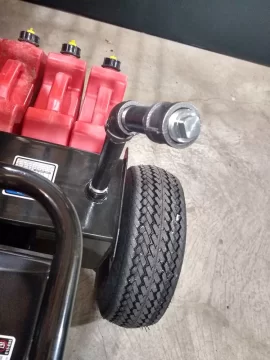

Are you splitting on a level surface? I've had oil come out of my old Speeco's vent hole before when I was splitting on an uneven surface, with the low side being at the vent hole. I've also had the same thing happen when towing it back to the garage, again on an uneven surface with the vent hole being on the low side. I now run an extended pipe with the plug/vent raised.

Just go to Home Depot and pick up the correct fittings. This is what I did with my County Line 40 ton. You don't have to go that tall though. I went taller than I needed to.
Also make sure the vent hole is pointing down, as you don't want water/debris to enter the tank. The only reason I put an elbow on it is so I could point the vent hole down.

Good deal. Thanks for the pic.
