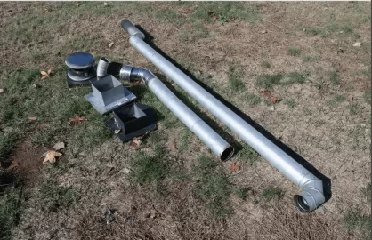

So this Accentra is currently uninstalled. Its roughly 4 years old, and has "been regularly cleaned" (coming from somebody on CL lol). I asked some very basic questions and gathered some further info. I was told both the igniter and control board have been replaced under warranty. This was somewhat concerning to me seeing 2 major parts were already replaced in such a short span. Also includes a good amount of ducting. At least an 8' section with the thimble and cap, which would probably be all I'd need as im planning on going straight up through the ceiling/roof as its going into the living room which was an addition (no second floor above). I also asked the seller if he was okay with me bringing a bag of pellets and testing it out, to which he agreed. All in all it seems like a great deal to me considering they're roughly 4k new and the asking price is 1,500.

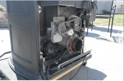

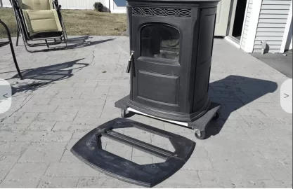

That should be more than enough stove for the house, you may need to move the air around in the house, ceiling fans in reverse in the winter and on low. Most fans on medium can cool the warm air down. the photos do show the stove as being clean. You may need to check the feeder box to make sure it cleaned out. Welcome to the forum.

Good stove for your application. Igniter replace in a 4 year stove is typical ,just replaced mine it was 3 years old and still working, just a precaution is why i replaced it. A board replacement seems odd for a 4 year old stove, but if the previous owners never used a surge protecter could of been as simple as that, or maybe they wanted a newer software up date on there board. I would not be overly concerned. Stove looks clean in the photo! Oh the loose looking chain on your auger drive is normal, just in case you were wondering.
