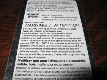

Something that came up in my install of a liner done last week by a WETT certified tech, was the issue of insulating the liner.
My install is in a 75 Y/O masonary chimney that has combustables touching the brick exterior in many locations. After the install was complete, I came across the metal tag that the UL folks require, and noted the comment that the liner met UL1777 when installed in a masonary flu with 1 inch of airspace around the exterior of the flu, and that insulation was required to meet a zero clearance spec when the 1 inch air space was not respected. When I asked the owner/tech about this, he indicated that he has never installed insulation, nor has he heard of the requirement.
Update - I first posted this refering to UL1777 but should have refered to the tag covering CAN/ULC S635-M90/S640-M91 and ANSI/UL 1777/UL-641/UL-441.
Note that I came across this info only on the metal tag, not the install instructions, and not the manufacturers web site, and not from the WETT certified tech/business owner.
Yesterday I confirmed the specs with the manufacturer, which require a 1/2 inch wrap/clamps/mesh that retail for roughly $400 Canadian. Keep in mind that the dimensions/requirements will vary with the product/manufacturer used. he also noted that he sells 2400 liner systems a year, and maybe 100 insulation kits. When I asked why the instructions don't mention the insulation requirement, he didn't have a good answer, just to say that the tech needs to know his products.
I have raised the question again with the installer, and will not settle for it not being insulated, even if I need to pay for an extra uninstall/reinstall. I know I shouldn't have to, but first I'll get it done right, then I'll deal with money issues.

When you are talking about clearances we are talking about combustiblies, "wood". so your flexible liner can actually be inside your masonary chimney and may touch the inside of the wall of your chimney and you WILL not need insulation... but some prefer it, it also depends on the liner you buy and whether it was tested by UL with insulation or not.
Actually, Selkirk products require 1 inch of airspace around the flex liner to conform with the specs, The TCE liner I have needs 1 inch airspace outside the flu when it does touch the inside brick.
The issue here is it all depends on what conditions the liner manufacturer specified to the testing lab (UL or CSA) when the test is done. That is the only approved install spec for the product, no more no less.
In some cases, I was unable to determine the install specs for a given liner when researching a product online, like the TCE I have. Couldn't find the install specs on the Magnaflex site either.
Here is a pic of the tag in question that came with my liner.
  • [Hearth.com] purchasing flex liner for new stove
Correct because that is how it was tested, our liners were tested with 1" to combustibles but 0 " to masonary without insulation.
