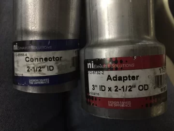

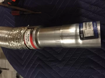

I checked the local exhaust shop, I can't believe they didn't have an adapter, also called the local harman dealer, they said just use 3" and clamp the heck out of it.... Very frustrating afternoon! I'll stay away from the pvc. Thanks

Problem solved !

The clamping three inch flex works fine. Just don't use PVC for the exhaust. Yeah, it has been done.

Probably is, nothing in the OM, but most point anyway, I got the adapters I needed and I'll have a nice tight fit using 3" metal flex.
