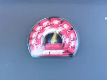

Let's just say that I go through the 200, 300, 450 drill with cast iron stoves but with every steel stove I have ever owned I just light the pup up and head for 500.
This is the thermo on top of the 30-NC sitting in front of my garage curing the paint. Their paint and five coats of mine on top of it. I lit it off and went up to five with the factory paint, cooled it off, painted it and did this burn before bringing it in the house.
  • [Hearth.com] Quad 4300 break in fires.
