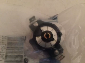

Hello
Snap Disc 1 is what turns on the convedtion blower at 110 Degs.
The one in the pic below can be adjusted from 90 to 130 Degs F
So if you set this for 90 Deg or 100 Deg then the room blower will come on sooner to blow out the heat. :-)

Hello
So if you set this for 90 Deg or 100 Deg then the room blower will come on sooner to blow out the heat. :)
And it will stay on longer at the end of a burn cycle to suck out more btu's. The air may FEEL cool but if you stick a thermometer in the air stream, you'll see it's still above room temp.
