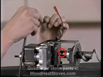

Is there a set screw were the motor and spring assembly attach if it is loose it could turn when few pellets dragging on it and slip when a lot of pellets?
From manual: Page 16
16. FEED SYSTEM
The feed system pulls pellets up the feed tube from the hopper,
using a hollow auger spring, and drops them down the feed
chute into the firepot. The feed rate is adjustable; for complete
instructions read the fuel feed system in the cleaning and
maintenance section of this manual. NOTE: The feed motor
will not operate when the front door of the insert is open. If
you are having fuel problems, check the following:
A. Check the ramp in the firepot to see that it is free of fuel or
other materials.
B. Check the set screw on the end of the motor shaft to see that
it is tight and not slipping.
C. Check the electrical power to the motor.
D. Check the vacuum switch hose connections.
Not the best picture it is a snapshot off a vhs tape but inside that black hole is a set screw.

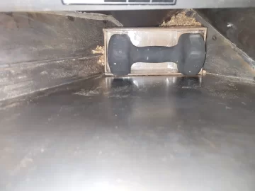

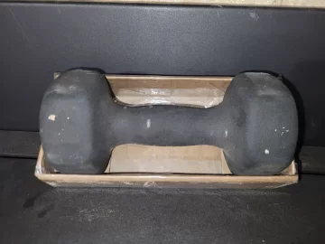

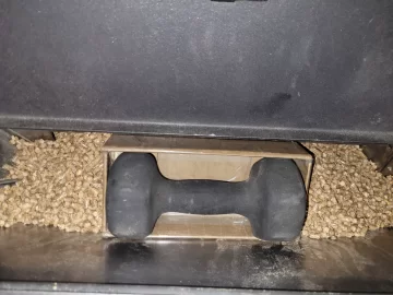

Oh, the pictures! First shows how it slid down to the bottom, pushing the pellets, but stopping above the auger!
Second shows how I fill the hopper and place this at the top so it slides and pushes the pellets down.
Third is just the box with the hand weight. The box could be deeper, but it works fine. It is very sturdy.
