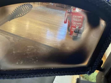

Tried to get a good picture. This is after 2 evenings where we had fires for about 3-4 hours each time. The picture really doesn't show how dirty the glass is.
To clean it I have to use vinegar and a green "scrubbie" plus a good amount of muscle.

Demo wood is extremely dry...so I wouldn't suspect the wood.
This isn't recommended but if it were me I'd crack the door open in an attempt to get a hotter fire to clean the glass and possibly reveal a more permanent solution, besides leaving the door cracked that is.
Assuming the stove is described as the QF 2100 Millenium, then I have the same stove. The difference is that my double wall pipe from stove to ceiling, then into class A chimney also 6" gives me over 20 ft for draft. I don't get any blackening of the glass, and just some thin ash film, easily removed with a scrap of damp paper towel. So I have to echo the suggestions of others that you need more chimney height, then have to run it hot enough so you get to shut down the primary air control (upper right, on the side) and get secondary burning.
A damp paper towel and ash from the wood stove will clean that right up.
