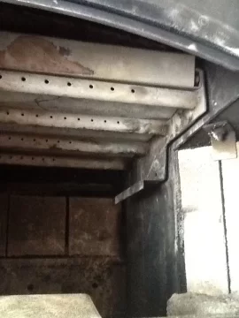

I have a 5100-I ACC. I took it apart to clean it and the chimney, now I am not sure how the baffle protection goes back on. I am attaching a photo.. Could someone please let me know if it is in properly? I sort of rolled it out when taking it apart but putting it back together the rolling was not working, so I lifted the baffles and blanket a little and was able to reinstall that way. Now I just want to make sure I have it in correctly. Thank you in advance, and stay warm.

I don't have this stove but see that there's information on page 24 of the manual about baffle removal and replacing. There are instructions and pictures of the correct position there.
I have the book but the diagram is confusing to me. I was hoping by posting the picture someone could tell me if it was in right. I need to get a fire going and just wanted someone to double check it for safety. Thank you
Yes, that looks correct.
