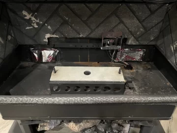

So it has two vents that feed the fire with fresh air. I took foil tape and partially blocked the one that’s under the pilot. I also took the foil tape and made a shield around the thermo/pilot assembly. I covered the other vent but more to deflect the air in another direction than cover it. Did that a week ago. Seemed to help but not completely. Still shuts off. I’ll tear into it again... see if anything has moved. I’ll take a video and post it.

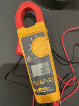

Are you taking readings on the thermopile after you turn the unit ON?
Do the milliVolts hold steady?
With the burner off it’s only putting out 600mv. When I turn it on it goes down to 200 then slowly drops then kicks off. This is the 3rd thermopile. They all do the same.

Was the pilot assembly always under that hood?
Have you tried burning it with that removed?
Can you take video of what the pilot is doing when the burner is lit & post it?
