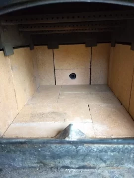

I just acquired one of these. It has been used without any baffle board for years. I have also heard of people simply removing the tubes and going with it like that, as well.

Does your stove still have the tubes in it, just missing the baffle?
Reactions: 4fire
Yes, it has the tubes still. I see this model just has the baffle and not the blanket as well. Can I replace the baffle and add blanket or is that overkill? I have all sorts of blanket but no baffle....go figure.

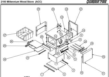

The manual I have shows the 2100 Millennium ACC with a pair of baffle boards and blanket on top of them. Looks like the earlier ACT model just had a single board baffle. If yours is an ACT version I'd try it with just the baffle board and see how it works.
