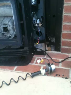

So I pulled the stove out far enough to remove the feeder assembly, how can I test the feeder outside the stove, like on a test bench? How do I put 110 ac to it??

Are the clamps the only thing that holds the flange together?
It is on both of my Quads. Look for bolts, just in case, but that's all I have are the two clamps that WILL snap your knuckles every time! Thinking about my silicone gasket fix, I would just put the top flange onto the silicone and not clamp it so that you had some thickness to compress.
