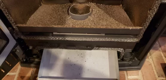

Looking for some help with my Trekker insert. I've had this installed since 8 Nov. Love the way it heats the main floor of my house.
One issue I'm having is NONE if hardly any of the ash is going down into the catch pan, I would say 95% goes up onto the floor around the burn pot. I've attached a picture to show you what it looked like after one week and just one 40lbs bag of Turman pellets.
Second issue I noticed since getting this installed is a large amount of dust collecting in the house since we had the Trekker installed, is this normal?
This is my first time running a pellet stove, had wood burning inserts in my last house and pulled a wood burner out of this fireplace. Never had this much dust before the Trekker so figure its coming from the stove.
Any helpful suggestions or comments appreciated.

Looks like you have not pulled the lever to empty the ash into the pan. Have you read the manual?
Mt Bob
Funny you should mention that, pulled that handle a couple times, even with nothing in the bottom of the burn pot. Had to put the handle back together during the first week's cleaning when it came apart.
What you see in the bottom the was after pulling the handle.

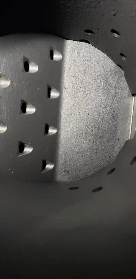

Here is the bottom of the burn pot when it was new, the left side of the picture is the back of the burn pot that you can see from the front of the stove.
Looking at it I'm not certain where the ashes can go.
I do know the evacuation feature the comes one about every 30 minutes pretty much clears out the burn pot.

According to the book the lever is just empty additional ash and large pieces of carbon/clinkers leftover in the burn pot only. The ashes on the floor of the firebox you have to remove yourself with a vacuum (!) At least from what I can tell.
If you haven't read the maintenance section, do so. You also are supposed to vacuum the heat exchanger monthly or every ton of fuel. You'll need to keep an eye on it to see how often you need to do so. It could be as frequent as every week depending on the quality of the fuel.

Yes I read that as well. I was just thinking that at least some of the ashes should be going into the ash pan, but after looking back at the photo I posted of the burn pot it doesn't look like it was designed to do that

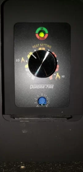

Try turning your trim adjustment all the way down= -4.
Got this worked out over the past month to keep from burning through a bag a day just to provide supplemental heat. Ended up with it set at -3 and the flame control at 1.5, depending on the outside temps I can go about 3 to 5 days.

Totally normal!!! The ash accumulates around the firebox as intended. This is the function of the "purge" cycle - it keeps the firebox clean so the combustion air can ignite the pellets. We call it the "popcorn" cycle. Combustion air comes UP through the holes in the bottom of the firebox. The holes are not there to allow ash to fall into the ash pan. Pulling the arm that slides the bottom of the firebox to the right will allow large clinkers or large unburned pellets to drop into the pan that aren't removed by the purge cycle. If you use a good pellet you may never see a clinker! It's one of the features of the Trekker - it self-cleans the firebox.
The ash in the stove is very fine and may be getting into the house when you open the glass door to vacuum out the ash and when you remove the baffle to vacuum the heat exchanger.
Good luck with the Trekker. It seems to be working fine.

The "purge" is the auto-clean. The lever that slides the bottom of the firebox has to be operated manually. That feature ended with the Mt Vernon E2s I think, which shares a lot of parts with the Trekker. I don't slide it each time because nothing accumulates there as long as your combustion settings are correct. I just hit it with the vac to ensure nothings in there.
