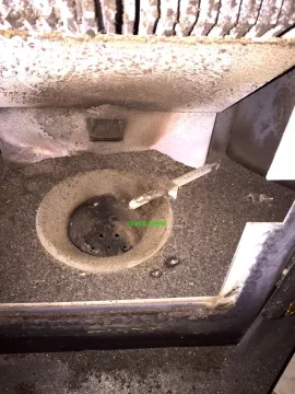

We have 2 of these here at the ranch and have had since 1993.
Does the unit have the metal fire pot ???
Likely it does.
The clay pots did not last all that long.
The one thing that can chase you all over is not always obvious.
The steel fire pots have a nasty habit of cracking in the area where the tapered rim attaches to the center core of the pot, and this crack will generally be right near the thermocouple probe.
When this crack gets large enough the air blowing into the pot through the crack (Area under the pot has forced air from the draft booster fan)
The air leaking in from the crack causes the fire to swirl differently and the probe does not get hot enough.
The flame will lean more towards the other side of the pot.
If the crack is large enough to cause this the only good fix is a new pot.
I welded one pot up and we finished a season with it, but it was only a bandaid fix.
Watch the flame as the stove fires up and burns, if there is a stream of air blowing the flame away from the probe, then there is likely a crack.
If the crack is there its easy to see usually
Here is a piccy I took a few minutes ago
The area where the green "crack here" is where to look.
This side of the pot is where the majority of the high heat is and the pot burns out and cracks
