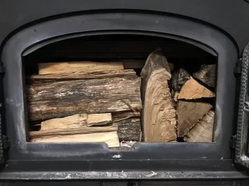

This is my 9th season using my 7100 to exclusively heat my house and I have settled on the loading plan of "fit as much in as possible and still be able to close the doors." Since I scrounge my wood for free, I am not blessed to have uniform length splits. It is whatever the person cut it to. I have come to enjoy the challenge of playing 3D Tetris. My typical loads are a combination of E/W and N/S like in the attached picture. A load like this will burn about 10-12 hours. Enough coals will be left for another full reload. Lather, rinse, repeat.
I love my Quad.
