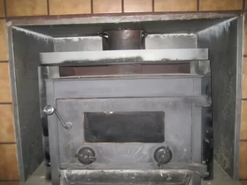

Here is a pic of the old insert.

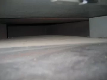

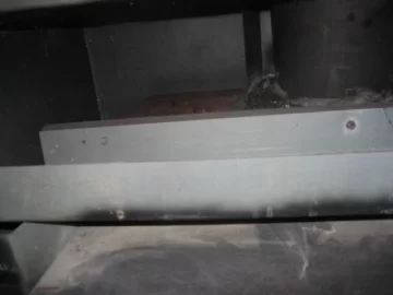

Here are a couple more.
These are taken from the top of the insert.

Tis indeed an unusual setup. Looks home brewed. Is that masonry surrounding the steel housing or just surface tiling?
It's all surface tile. Part of this project is to replace the tile over the hearth with that owens-corning synthetic rock.
Yes, definitely looks home made and not legal. After seeing the picture, the guy may be right in that he cannot do another wood insert.
jtp10181 said:
There is no masonry in the area where the insert sits. It's basically just a metal box.
