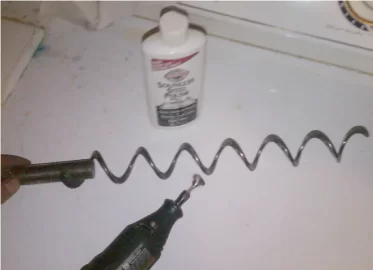

Wow this Quadrafire Classic Bay 1200 Auger was pitted, corroded and rusted in spots. It felt very ruff.
So I got a stainless steel bristle brush attachment for the dremel and smoothed it right down.
Now a little stainless steel polish and it will be up to snuff. Not new but in good working shape!!
Now it should pump out the pellets!! So how is your Auger? Any pitting or rust yet?

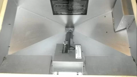

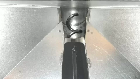

I have the same auger..... Nothing special.
Just a HOLLOW Spring..... What are you looking for? As far as responses go? Most use a Solid "Screw & Cylinder" type auger. While Heatilator & Quad (and maybe someone else, I dont know of any) have a Spring.
This leaves a large build up of fines at the bottom of the hopper. Tiss the reason I sift my pellets.

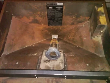

See pic of this hopper!!
Well maybe just a lttle elbow greese? I can use the steel brush too!!
