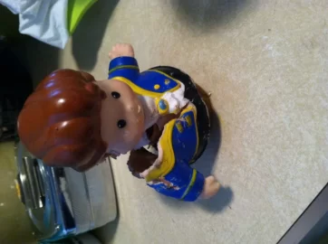

So I am really embarrassed to admit that I've been having stove issues and found the culprit in the auger (a fisher price little people prince). I really had to fight to get it out and it seemed to be fine but I keep tripping the snap disc for the auger. Any ideas? It was clear when I removed Prince Charming but now the stove is working intermittently. I cleaned the vacuum tube. Also the room temp is not keeping up with where I am setting thermostat. Help!!!
Time to jump the #2 snap disc and see if stove runs better. If it does, time for a new disc. I wouldn't run the stove too long like this as that disc is a safety feature for if you are overfiring the stove, or the conv. fan doesn't come on. And how did you get the prince out of the auger? I would also check your feed rate, and adjust accordingly to owners manual. When was the last time everything was cleaned? Behind bricks, heat exchanger tubes, exhaust path? kap
I cleaned thoroughly a week ago? Including disconnecting the stainless chimney vent and tapping all the dust out and vacuuming it out. I do the firepot and holes in it every other day. Is that frequent enough? The stove is not reaching the thermostat temp. It will work for a while and then stop feeding. I did snap both discs (on auger and one by control box) so I don't know which one is the issue. A combo of needle nose and screwdriver (and elbow grease I have a few bruises too) I went in through the little trap behind the hopper. Prince charming was a bit chewed up...
