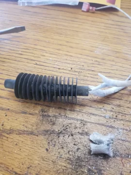

Had same situation with my harman. Ignitor was staying on all the time. Had to be a problem with the control board as the igniter cannot stay on by itself only. As someone said it is a triac which is a small part on the board. I went ahead and bought a new board since my stove was 8 years old anyways. And of course I bought a new ignitor while I was at it and that fixed the problem. You could save a lot of money if you just go ahead and get the board yourself. Very easy to disconect a couple wire harnesses and pop out.aying on..
btw: this is what happens after prolonged or constant current going to the ignitor
this is from a harman free standing stove:
